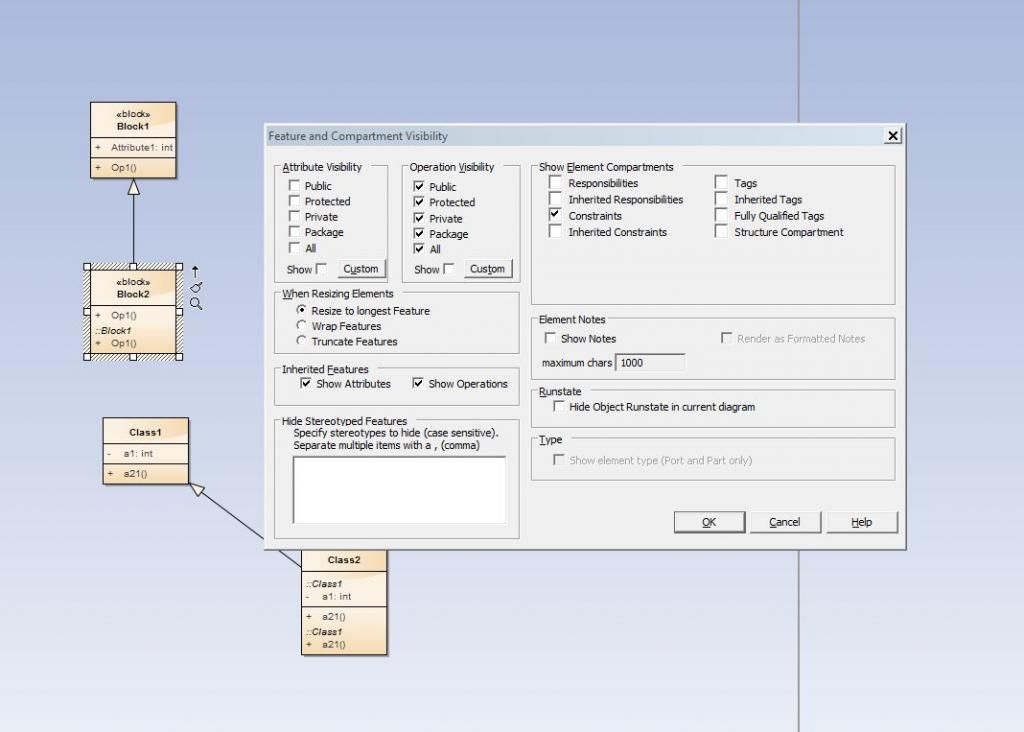

Select the class and press Ctrl+Shift+Y. In the Feature and Compartment Visibility dialog, tick Inherited Features | Show Attributes.

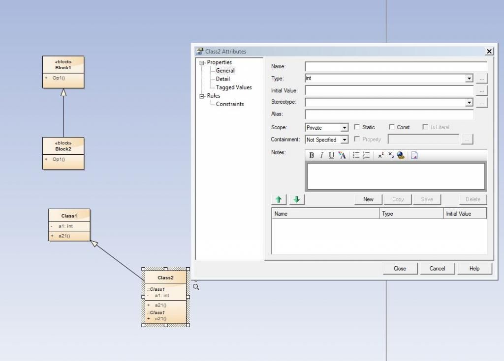

When I tried that with a class, it kind of worked. What I mean by that is this:
Here (where I'm dealing with UML classes Class1 and Class2), we see that using your process did make the inherited attribute a1 show up on the diagram. However, when I right click on Class2 then go to Features & Properties -> Attributes there is nothing. a1 is nowhere to be found.

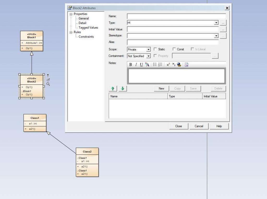

However, my work is in SysML 1.3, so I was trying to get this to work with blocks. When I tried your suggestion on blocks it didn't even show the attribute on the block, and again:
And in this case the same box is checked:
So what could be going wrong here?

1. SysML blocks don't have attributes; they have properties (parts).
2. Attribute a1 will not appear in the attributes list for Class2 because it's declared in Class1. That's the point of inheritance: that you don't have to duplicate the declaration.
« Last Edit: July 18, 2014, 09:46:54 am by KP »
